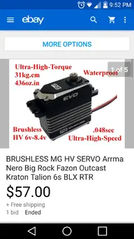

I use the one below on eBay. Less than $60. Brushless and specs pretty good. Have been using in Nero and Outcast no problems so far (6 weeks) so we'll see over time. Also on Outcast it doesn't flex like plastic stock servo with rubber washers, I think they greatly contribute to flex.
EVO P2 BRUSHLESS Digital, High-Voltage, WaterProof, Ultra-High-Torque, High-Speed, Stainless Steel Gear Servo. Ultimate Racing and Bashing Servo for 1/8 and most 1/10 Scale Gas, Nitro and Electric Vehicles, Watercraft and Large Aircraft. Excellent upgrade for 1/5 Throttle/Brake Servo.
31kg.cm of Torque and .048sec Speed @ 8.4v!!!
  • Brushless Motor - Made in Japan
  • Voltage: 4.8V - 8.4V
  • Speed: 0.10sec/60° (6.0V), 0.07sec/60° (7.4V), 0.048sec/60° (8.4v)
  • Torque: 18.2kg/cm (6.0V), 24.8kg/cm (7.4V), 31.4kg/cm (8.4v)
  • Dimensions: 40x21x38.5mm
  • Weight: 68g
  • Case: CNC black anodized aluminum case
  • Gear: Stainless Steel Gears

I got one.....love it...also got the banggood $13 one for backup...
