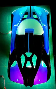

This is the photo shop color render I did as the example for the paintjob I wanted for the Bugatti Bolide rc body made by Performance Limitless.
And here is how the paintjob turned outšŸ‘ŒšŸ”„šŸ« šŸŽļøā€¦ alright guys I’ve just posted tons of photos from the month of October so let’s not get too far ahead before the following video upload comes out, which should be pretty soon! So please stick around for the supportšŸ’Ŗā€¦ it’s because of you that this project exists!🫵
THIS VIEW IS OF THE (UNDERSIDE)
AND HERE IS THE BODY FROM THE TOP AFTER REMOVING THE MASKING.
I will explain in depth the steps I took in order to be able to light it up theBugatti body like this. I’ll go into depth with all of the above in the upcoming video guys🫵🫵😁🫠

So yes it was sealed with white as you see it lighted up… but it’s a special mixture of white, mixed the same way that the colors were mixed in order to transform them into a translucent paint pigment.. so yes I will explain and show my process in the upcoming video uploadšŸ™šŸ«µšŸŽ¬

Thanks man, it’s sure coming out well!! I love the paint job too, came out just like the photo shop render I did.. next is to carbon wrap the body minus the blended colors. The wrap will give it support and adding 1.5mm lexan walls to the existing .75mm body walls is going to make it overbuilt and after adding some flush mounted support panels to give the model design the realism that I’m going for. I’ll attempt 100mph again on this platform that I did with the Felony, but not that I have this UNPREDICTABLE custom’d out Bugatti Bolide by
