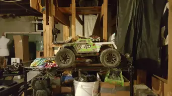

Re-Ripped my brand new ProLines - Have braided fishing line and will reglue and go that route. Threw on my Avalanche MTs - very similar to the Boots - lil smaller.
CYS Brushless Waterproof servo 277/oz @ 7.4V ( Is the Nero running on 6 or 7.4v? hoping 7.4..)
TBone front bumper & Wheelie Bar
Proline SuperSwampers 3.8, Avalanche MT, SRC Terrain Crushers & DBootzzz

Lol. Man I can't wait till I find a good spot. I just adjusted the springs to raise it up and what a difference! Clears the grass a lot better. The wheelie bar wheels are an inch higher. Less pull on the servo I would guess too. Just realized there's a skateboard park I could swing by ....
Yeah i moved shocks to third hole in and put 70wt front 60wt rear and turned up pre load also jacked body mounts up a couple holes it looks much better. Has nice clearance and still handles like a dream.
