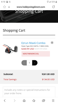

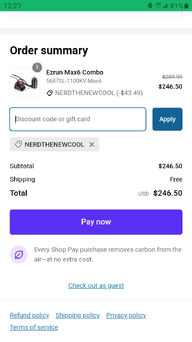

Cuz we cheap I guess. LOL.
I went on HW direct, think it was $350 or so seperate..max 5 and 5687.
BTW, the coupon code value went down.. see here..
August 5th, then today's price.. weird.
They must've just dropped this 5690 motor, wasn't on their site a few days ago?
