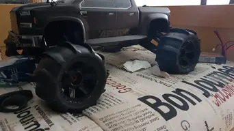

Got my Redcat Terremotos. They are tall and narrow. Kinda like that for handling. They behave to a point and then crazy town. I think I will give 4s a try with these tires. I just tried em out front. Off to Albert Leonard for sum jumpin. When I get back I will list all those tires - might come in handy.
