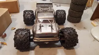

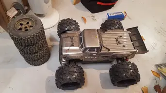

Here is a quick tire upgrade. These are original big joes on tech5 rims zero offset. Could say my baby got new shoes! I'll run these tomorrow see how they do
I did trim and little on the front bumper to get the tire to clear. Outcast has about the same width as before, just filled up the space between the tires and the body.
